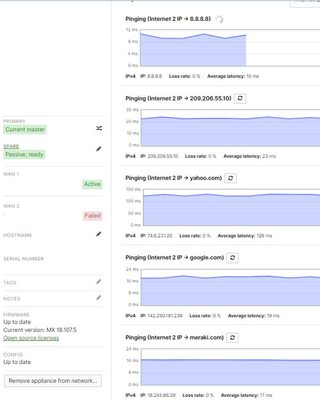

Hi Guys,
an uplink is sporadically displayed as down.

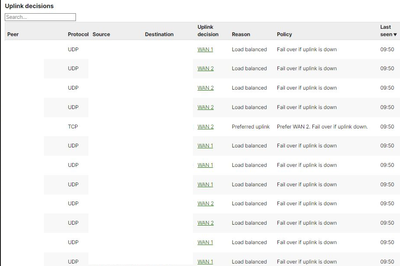

However, VPN traffic is transmitted without any problems.
I looked at the Meraki documentation and ran the failover connectivity test over Internet 2. It works.
Also the outbound IP addresses and ports from the firewall overview are all open
I am looking for possible solutions.
Thank you very much

Looks like a false positive then.  Perhaps it can be that the MX does not reach dashboard fully via WAN2 but the rest of the internet works fine causing the VPN traffic to work too.
