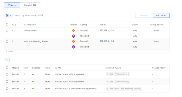

I have only port 5 connected, clients are given IP's in range 192.168.2.0/24 via DHCP

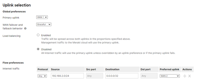

Uplink is configured as Primary WAN1, Load balancing is disabled and I have dedictated Flow Preferences for ANY 192.168.2.0/24 to ANY 0.0.0.0/32 to use uplink WAN2.
  • I see WAN1 is used (via check MyIP on internet) so I wonder why.
  • I also see in Appliance Status that WAN1 is Active and WAN2 is Ready.
  • When I unplug WAN1, then trafice is routed over WAN2 to the internet.
Any idea what I configure the wrong way? Do I forget someting? Is my Flow Pref wrong?  The only thing I can think of is that in the VLAN config the uplink is set to Any but when configuring the IPv4 VLAN I never had the option to choose a certain WAN as uplink.

I think you're using the wrong mask with your destination.   Try 0.0.0.0/0
Unexus
Instead of 0.0.0.0/0 I used any
You can also use "ANY" instead of subnet in this case.
