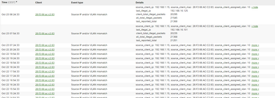

I am getting a lot of events: "Source IP and/or VLAN mismatch" from one device (I think is a camera).
source_client_ip: 192.168.1.15, source_client_mac: 28:F3:66:AC:C2:83, source_client_assigned_vlan: 10  « hide
last_illegal_ip192.168.16.106
client_total_illegal_packets19828
all_total_illegal_packets20942
last_reported_total20906
I dont understand why! Anyone have any idea?

yes I have tried to sniff the packed but nothing is captured for this device.

:)' my bad, I didn't notice the interface selection was Internet.
However I cannot understand a lot from the packet-capture. There are all the time arp packets between meraki and this linux device Shenzhen Bilian.
Then came up this IP 192.168.16.104 😕
