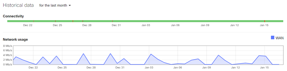

2)  Based on what I see from Dashboard MX64 Uplink, I want say ISP PL% issue is the likely culprit.
From MX64 Uplink - I could be wrong here but I recalled any PL above 0.5% would impact streaming quality.
s0UXZzk
From MX64 Network Usage - we're nowhere near the 30Mbps uplink limit.
R0Gkrz1

Personally I'd engage with the ISP as that kind of packet loss is dreadful.  Below is the graph from my wfh MX64 on a home VDSL 55/10 connection in a small UK town:

Once your packets hit the internet they’re out of your control. I would say this looks like an ISP issue. The latency on the link is on the high side and loss is quite choppy.
