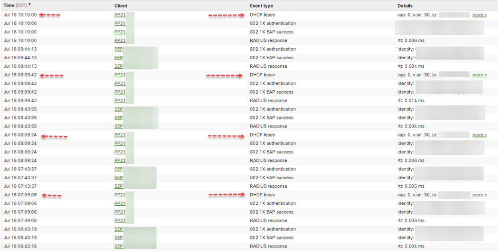

This is a fairly complex issue.  We are running the 14.39 firmware with MX65(W) and MX68. We activated the 802.1X / MAB auth ( hybrid ) and since that activation every device is renewing it's DHCP lease every single hour ( 1 hour 16-18 secs )
This is annoying because it is flooding our logs and the lease we are giving to our devices are 24h ( should renew at 12h ) This is affecting all our 2k teleworker.  Devices that are authenticated via MAB do not renew every hour. Cisco IP phones ( multiple models , also do not renew but are reauthing every hour ).
In Cisco ISE we don't see anything suspicious and everything is working fine on our MS. MX is a different story. See the logs below :
As anyone seen this issue ?

This is what I got from support  :
After gathering the data and discussing this with our Engineering team we've determined that this is the expected behavior for MX devices using 802.1X based authentication. The current reauthentication timer on the MX is set at 3600s / 1hr, and I've confirmed that unfortunately at this time we are unable to change that value at all, so this is all working as expected in this situation from what we can see.
I'm still worried about the DHCP renew at every reauth. I don't think that is a expected behavior...
Highlighted
Building a reputation
Re: Since 802.1X device are renewing lease every hour
Well ,
Support was able to reproduce the same issue in their lab. But it is only affecting Windows OS...
"I was able to get a Windows 10 client setup in my lab and in that case I am now seeing the client perform a DHCP Renew every time it reauthenticates via .1x, exactly like we're seeing in your client sites. So in this case it appears that the DHCP transaction after a .1x reauth is expected for Windows 10 clients at least. "
Has anyone experienced this issue  ? Anyway to fix it ( parameters in windows or something ) ?
