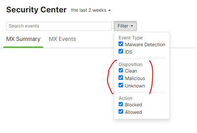

I have AMP and IDS enabled (MX85) however I have never seen a single log in the security centre for three years! Support desk have not given any solution they just say try disabling and re-enabling these features but it never works.
Any ideas why I am not seeing any logs for this?
@StarBlink ,
Try enabling all filters.

Balanced yes. OK makes sense now...
@StarBlink ,
StarBlink
Thats done it. Thanks
