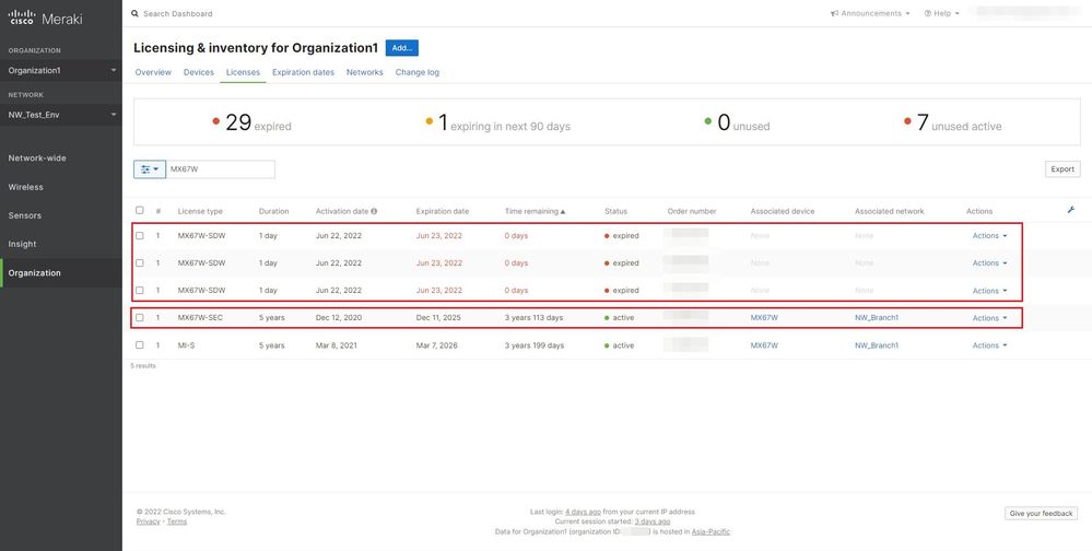

In the case of PDL, the purchased license is simply added to the Organization.
For example, I have separate Advanced Security License and Secure SD-WAN Plus License for MX67W.
The license value is not converted.
The license expiration date is also independent.
I sometimes wonder if my interpretation is correct.
It is difficult to confirm the operation of the license registration, so it would be better to check with Meraki sales.
Hoping there is another better way.
Thank you for your response and the following comment with the screen shot.
That does not sound good but it explains the current license situation.
