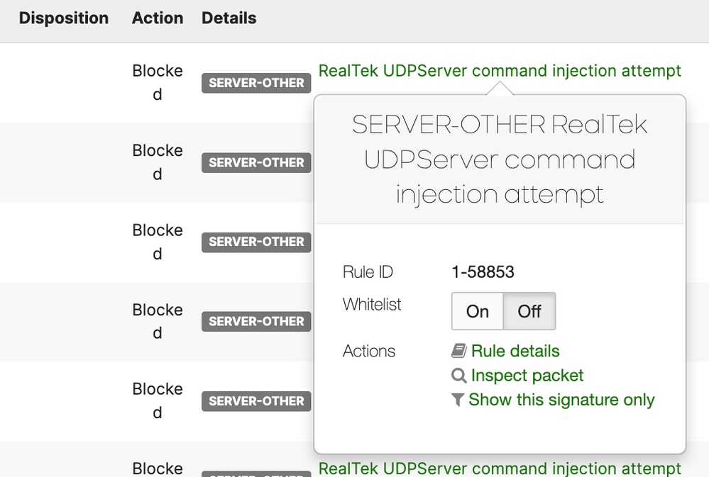

In Security Center if you click through to the event you can see the packet and download the pcap of just that event.  Here is an example I found:

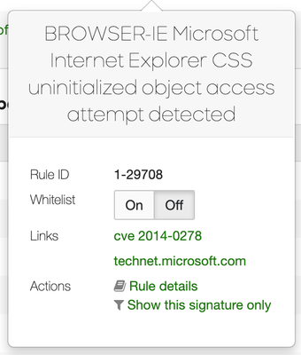

BrandonS, that is exactly what I was looking for, but we don't have the Inspect Packet option. My signature match options are shown below:
How do I enable the Inspect Packet option? Encouraging feedback so far.

I think you may only see it under the MX Events tab and not the MX Summary tab.  Which makes sense because you would be interested in the specific event, not the summary of events in this case of seeing the packet.
Bingo. That's it! Thanks for your help tracking that down!
