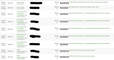

I have had a ticket open with Meraki since January....yep you read that right.  We have an internal server that has been getting hit externally from a number of IP's. This particular server has no forwarding, the outside world should have no idea about this server.  The only response I keep getting from Meraki is "This is unexpected behavior our support team is looking into it".  SINCE JANRUARY!!!.
I have scanned this server into oblivion to make sure it is not compromised.  This server has no additional software installed. It runs 2022 Datacenter and is fully patched. Can ANYONE help me figure this out, as I need an answer, I need to get this resolved.  I have had 254 events this week alone, and this has gone on since January.  This is just a shot from yesterday and today. Again, this server has nothing forwarded to it, nothing reaching out from it. The world should not know it exists.

I am just frustrated that Meraki says this is unexpected behavior but has kept us on the hook for 5 months now for a solution.  Also, no sharing is enabled on this server either. It is not accessible from the network. I disabled ICMP long ago. External IP's in the IDS logs are all over the place, no pattern.  Our webserver, which does have external access gets less IDS hits than this server.  Maddening. I just have nothing else to try.

Totally agree with you. Unfortunately, I cannot sit and run through Wireshark logs all day (but I have ran Wireshark on occasion and tried to see packet info, but nothing stood out).  We do not rely 100% on the firewall, we do have other solutions to scan and prevent infections and intrusions. But I totally agree, nothing is 100%.  Just hard to believe after 5 months of scans/investigations, if the server is infected, nothing has found the infection(s).  It has been scanned by several enterprise solutions, none of which has found anything.

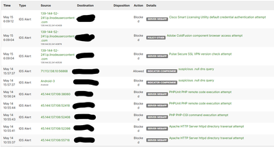

This URL comes up a lot which is terrifying...lol. It is always blocked, but no idea why DHS is trying to get to one of our servers.
vulnscan5.cyhy.ncats.cyber.dhs.gov

Not a web server, not a proxy. It does run secondary/backup DNS, but our primary has not gone offline, is always reachable.  We do have firewall/inbound rules created, nothing forwarded to this server, no NAT.  Not sure it would be a bad DNS request, this would get stopped at the client before it hit the DNS server. We have allow/block rules set for our HIP system.  The IDS alerts that pop up from this server are not generated internally from a host callup, they are all incoming (from what I can see).  I appreciate all the help from everyone. Meraki's response again yesterday was "Our engineers are still investigating this issue, and no timeline to resolution".
FYI Today already, no we do not use AWS for anything.
