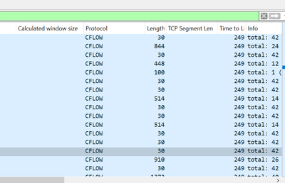

Screenshot from MX
When i run the Wireshark on windows server i don't see any communication with 2044 port going to meraki however meraki is sending the net flow traffic if you see the above image
ip.addr == 10.100.xx.xx && udp.port == 2055
