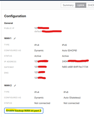

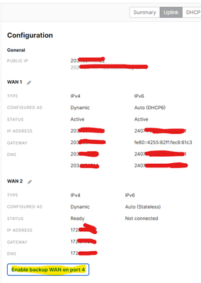

kipbriann
Not possible to convert a LAN Port to WAN port in Meraki.
On some models, you can convert the first LAN port to a WAN port.  You do this under the Uplink tab.
Dan91
Yes, I am aware of that thank you.  I did this on a mx-67c model.  So I was hoping it was possible on the MX85.
I just checked an MX85, and I see that same option available.
