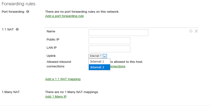

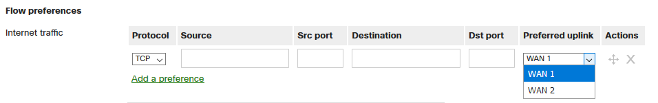

I hope you are referring to following features.
1) Flow preferences
Security appliance->Traffic Shaping
2) NAT & Port Forwarding
Security appliance->Firewall
