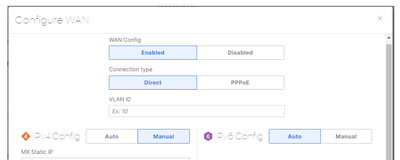

This error appeared on newly installed MX75: This device is using a DHCP IP address from VLAN 0 instead of using configured VLAN 1 .  History is that previous network equipment owned by soemone else so we took equipment out and installed/created a new network, Everything seems to work but this error. Previous installation had the Meraki ms120-24 directly connected to the ISP. Config now is:

   The ISP is still handing out dhcp . We turned off dhcp in the MX75. Do we need a static IP from the ISP?
Your WAN is probably configured with VLAN, just leave it blank.

Thanks for your help. I made the change and the error cleared within 3 minutes and the network stayed up.
