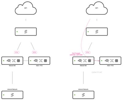

KarstenI
I did this but not with an additional MX, I use an ASA or an FTD for this. But the concept is the same. Based on availability of addresses I use one of these two setups:

KarstenI
StingeyNinja
Is there any reason this approach wouldn't work if I used an MX in place of the ASA/FTD in these diagrams?  Sometimes it's nice to stick with a single platform, single licence renewal, etc., and cloud-managed patching on the MX is always a plus.
KarstenI
Yes, it is also possible with the MX. Your mentioned benefits are real, but the drawbacks of the MX for extranet VPN are also often relevant.
You won't have a single license renewal if you place the MX in a different dashboard org. But the rest should be fine.
