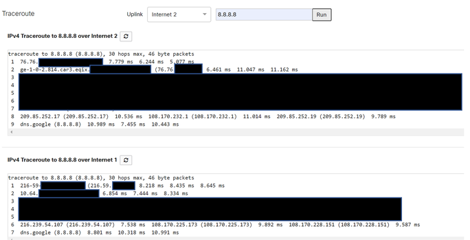

What is strange, is that a traceroute from the MX will show the correct path when tested with each uplink. WAN1 (in failed state), will show the expected next hop and the ISPs internal hosts. Those will be different from WAN2.

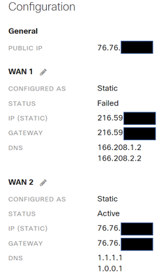

The configuration is below. Clearly, traffic can flow on that interface, but status will not change to Active, and I suspect this means it will not send client traffic through it (it is configured to load balance).

The traceroute shows the MX can reach 8.8.8.8 with either link, and in each case going through the ISP assigned to that link.
I've added 172.217.10.142 (one of google.com's addresses), and i get the same results: I can run a traceroute from the MX, each one goes a different route and through the ISP connected to each link, but WAN1 remains in failed state.

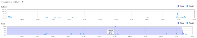

The historical data seems to show that 8.8.8.8 is reachable for both connections too:

You nailed it. I trusted the ISP DNS servers instead of going with Cloudflare.
Once I set 1.1.1.1, the DNS test succeeded and the link became active. The link you added was very useful in understanding the process.
