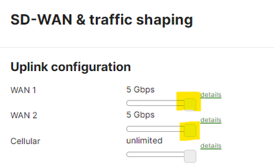

The above comments are excellent.  The one thing I'll mention is any WAN traffic shaper you have configured on the MX68 (under Security & SD-WAN/SD-WAN & traffic shaping) will be kept - whereas you often want to use the higher performance option offered by the MX105.

Took my longer than I care to admit to work this out in swapping MX84 for MX75
