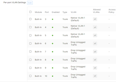

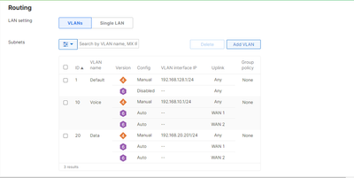

Hello Guys,
I just migrated MX68 to my office network and have only set up the below configuration and noticed the network is slow. Please guys kindly assist where I need to make changes to allow the network flow to be good.
Regards,
Emmanuel

In what context is the network slow? Accessing resources internally or externally? How many users do you have in the network?  What is downstream of the mx?
@DarrenOC Thank you for your response. It is accessing resource external. There are 32 users in the network. The downstream is a MS-120
