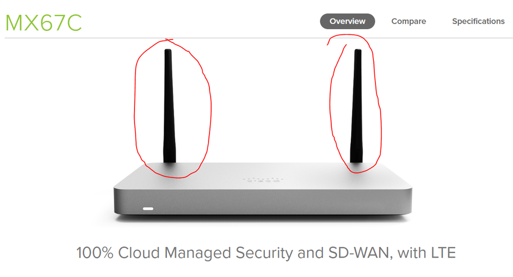

You're kidding, right? I honestly can't tell; but those antennas are tiny as heck and Meraki doesn't provide a high-gain cellular antenna option for upgrade. We have a MX67C in test right now in a location is way better than anything we'd likely get in the field and I'm currently dealing with wildly slow speeds and ridiculous latency. AND THAT'S JUST COMPARED TO ANOTHER VENDORS DEVICE RUNNING ON THE SAME LTE NETWORK. This is bad and frankly, if the lack of SSL off-loading capabilities wasn't a deal breaker for us, this pretty much would be. It's really a shame too, since I personally am a Meraki fanboy.
The MX67C does use external antenna.  Refer to this picture:
https://meraki.cisco.com/products/appliances/mx67c#technology
Meraki only offer the one type of antenna (that ships with it).  You would need to source your own antennas seperately.
That note RF signal drops off pretty quickly, so you want the RF cable leads to be as short as possible, or you'll need to compensate by using lower loss cable (and the lower the loss the more the cable costs).

The MX67C does not support external LTE antennas!!
The antennas you se on pictures are WiFi.
If you need modem with external antenna MG21E(POE powered) is the only option with external antenna.
Or you can go for MG21 with internal antennas to extend your 3G/4G option
GreenMan
Meraki Alumni (Retired)
Are you sure you're not looking at an MX68CW, @MerakiNorway ?
The MX67C does not support WiFi   (C stands for cellular)
The MX68CW supports both cellular and WiFi.   (W stands for WiFI).   Because the antennas fitted to 68CW serve both Cellular and WiFI and Meraki have to ensure customers stick to WiFi power rules, the antennas are fixed.
For the MX67C, however, you can unscrew the antennas that ship with the unit and replace with cellular antenna with RP-SMA connector(s).   If the antenna + cable combination you use allows you to get a better mobile data uplink, that's great, but Meraki will not support such a configuration.
