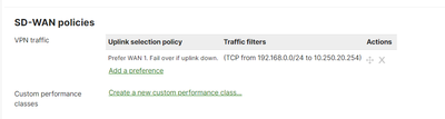

Do you have link balancing active? If so, have you tried to create an SD-WAN rule forcing this traffic to this specific destination and giving preference to only one of its links?
Something like this.

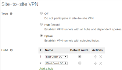

Do I need to configure the VPN route for the device although the clients connected are directly connected? Our connection is as such: The MX is connected to a dummy switch, the clients are connected to the switch. I am thinking if we are needing to configure the traffic to go through the HQ. Is that possible?
In SD-WAN, route exchange is automatic, can you show how your VPN is configured on both sites?

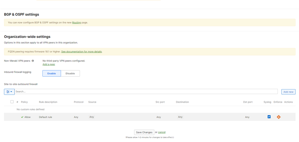

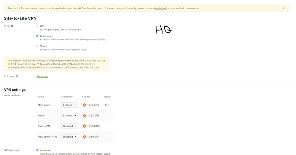

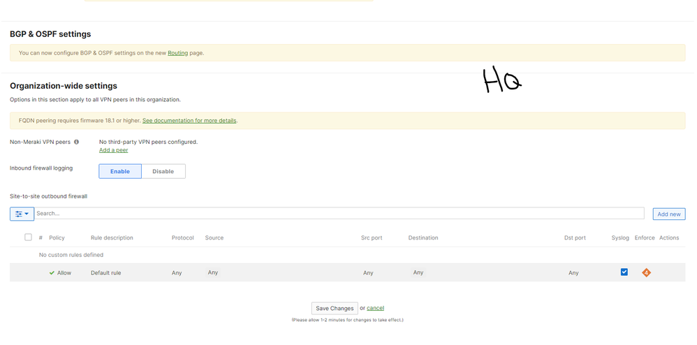

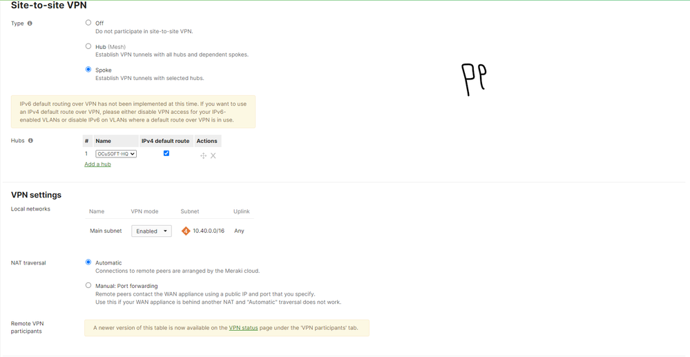

Are you asking for the Site-to-site VPN from the added network and also the HQ?
This configuration.
DKetchum
Just browsing
Attached are the VPN configurations.
It looks good, so I return to my original question, do you have two links and do you balance the links?
