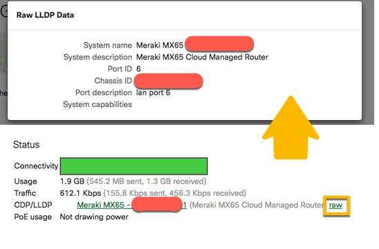

If you really need to find what port the switch is connecting with on MX you can get it from the raw LLDP data information on the switch ports.
1) Select your switch
2) Look for and select the Meraki worm symbol indicating the MX is connecting to it.
3) Clock "raw"
4) Look at the port ID.
