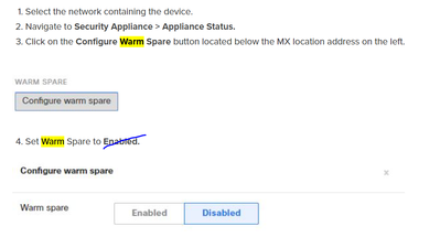

@SouThong : Well In a scenario of HA setup where you set up Active/Passive, The MX that is currently acting as an Passive warm spare has no traffic passing through it. This is a dynamic designation. So if you disable there should not be any impact until unless your primary MX down and failover will not be happened.
As you disable the Warm Spare configs and you need to re-enable that in order to work again.

@SouThong : You want to disable the Warm Spare before removing one MX from the config ? Disable the Warm spare .. But your network has consequences. .Make sure you know what you are going to do

@SouThong if you convert and active/passive HA pair into a single unit then the traffic will go out of the remaining devices IP as opposed to the shared virtual IP that is currently being used.  You could always set the physical device's WAN IP to the current virtual IP to minimise the disruption.
