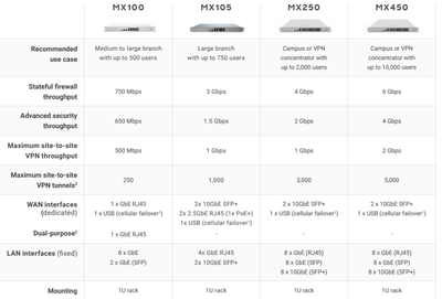

Pretty easy: you won't be able to squeeze out more than mentioned in Meraki's data sheets. User count may be "conservative", but not that conservative.
I'd definitely go wfor the MX450.

@Stans : MX250 with the number of 2000 users and Capacity of maximum throughput of 1 Gbps of VPN is on the test environment or may be on EFT ( Early Field Trails). I would recommend you to go with MX450 as per your requirement of 7000 user counts and 2 Gbps of VPN throughput.
