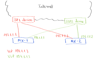

I have a topology like this:
  • MX-1 is the primary appliance, MX-1 is connected to both ISP1 and ISP2 routers
  • MX-2 is the spare appliance, MX-2 is connected to both ISP1 and ISP2 routers
  • The ports Internet 1 of MX-1 and MX-2 are already configured and are operational
  • The ports Internet 2 of MX-1 and MX-2 are not configured yet (ISP2 did not provide the public IPs)

I configured all IPs and saved the configuration but nothing displayed :
When I clicked on the pencil icon, I could see all the parameters that I configured.
I checked the ARP table but did not found any entries for Internet 2.
