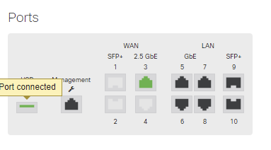

Both of them claims that there is a connection on their USB port in the dashboard.
I dont know why. Maybe a UI bug. - Because there is NOTHING connected to that port on either of them.

The usb gui bug is also on mx95.
