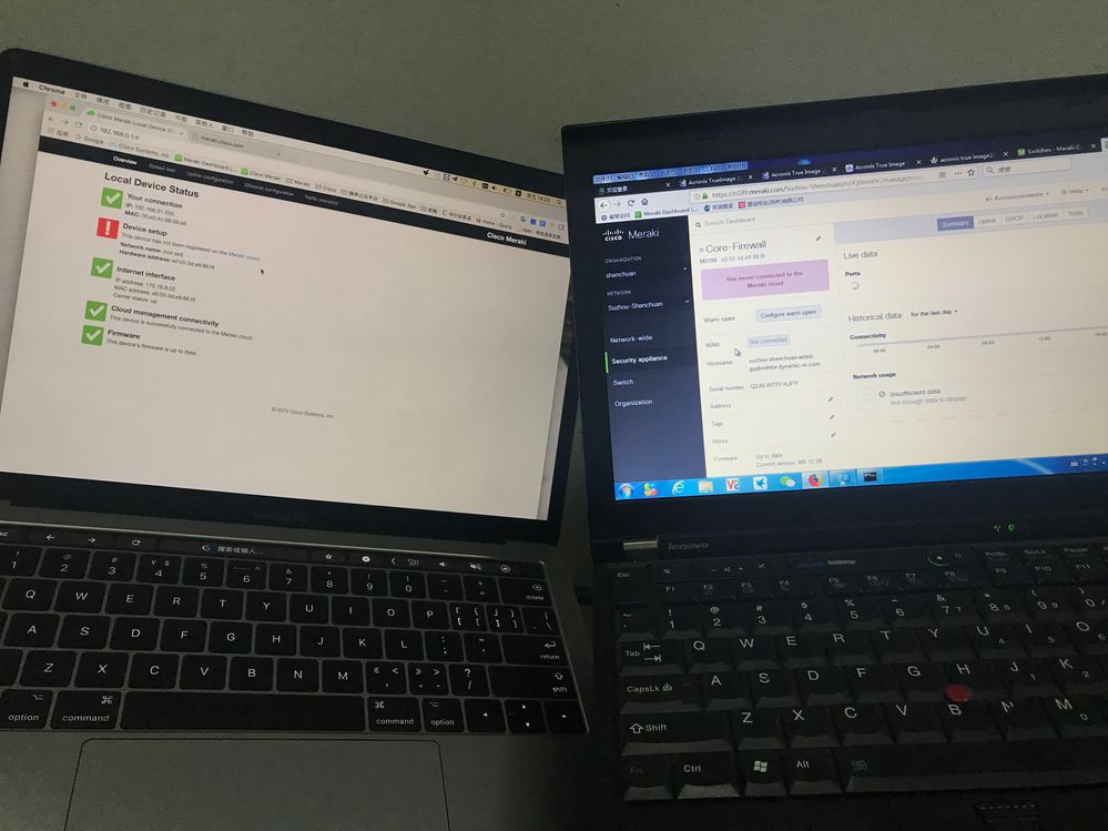

today , I configure my firewail MX100 and Core switch MS350, MS350 local manage
configure manage IP, after ms350 can already cloud control manage , i use same way
configure my firewall WAN IP, the WAN port is static ip ,so i need local configure it
after configure finish, the web page tell connect to meraki cloud, the status led is write,
i access cloud manage , it still offline, i don't know, what do you think ?

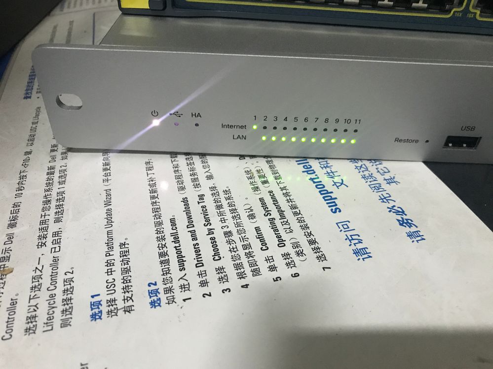

2. i find my firewall after booting, Firewall port status lights both are on. so i want know,
why ? i‘m not plug in any line,
3. my local manage configure page is 2013@ version , do you know the version ?
     can you tell me why? i get the 2013@version local manage configure page ?
Please see attached ,

When statically configuring the IP address make sure you use valid DNS servers (such as Google's 8.8.8.8 and 8.8.4.4).
Make sure the serial number on the MX100 matches the serial number of the device in the Dashboard that you are looking at.

You might also want to check that there is no firewall upstream which could be blocking connectivity to the cloud (help>firewall info) within dashboard shows the range of IP's/Ports that are required to be opened up on the firewall to allow for cloud communication.
