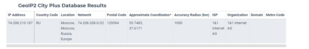

We just had a couple customers that called in having problems to specbooks.com
Nslookup reveals
Non-authoritative answer:
Address: 74.208.210.187
Aliases: www.specbooks.com
This tool classifies that IP block as Russian
https://www.maxmind.com/en/geoip-demo
Other tools do not

Anyone experience false positives with the geo filtering?  Would be nice to have the Content Filtering take priority over the Geo-Filtering but wondering if anyone else is having problems with it today.  This seems to have just started today.

Yep, we’ve had this a few times happen to various customers.  It may just clear itself when those various datasets are updated but sometimes we’ve had to remove the geo filter.

The output from the second tool you show, whois, does not show where the IP block is in use.  It shows where the company that registered the IP block is based.  This is a very different thing.
