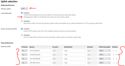

One thought - could you please review Uplink selection & Internet Flow configuration.
  • Security & SDWAN > SDWAN & Traffic Shaping > Uplink selection
