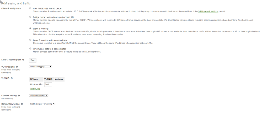

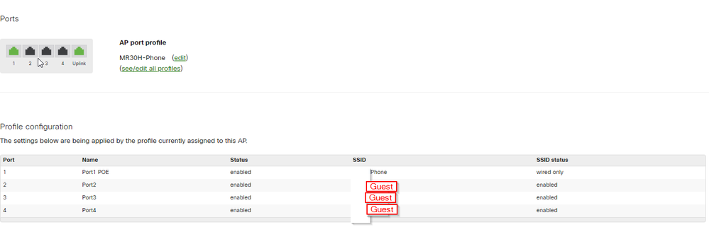

No, because all the phones are connected to an MR30H I can only assign one VLAN per port unlike with switches. (Voice Vlan is 200)2019-11-12 09_40_25-Window.png2019-11-12 09_38_59-Window.png

OK, so if we assume that the phones are on VLAN 10, and they are connected to a port on an MR30H, then one must configure a "Wired-Only" SSID to assign to the port profile used to configure the MR30H port. Now, since MAC whitelisting is only available on access ports, the MS switch that the MR30H hangs off of MUST be configured as an access port in VLAN10. The Wired-Only SSID then must be configured to bridge to the native VLAN, which would be VLAN 10.
As a side effect of this config, any additional SSID's condifured for WiFi clients on the 30H must also be bridged to native VLAN. Since the switchport is configured for access 10, if you configured an SSID to brigde to a tagged VLAN it will be dropped on ingress to the switch port.
