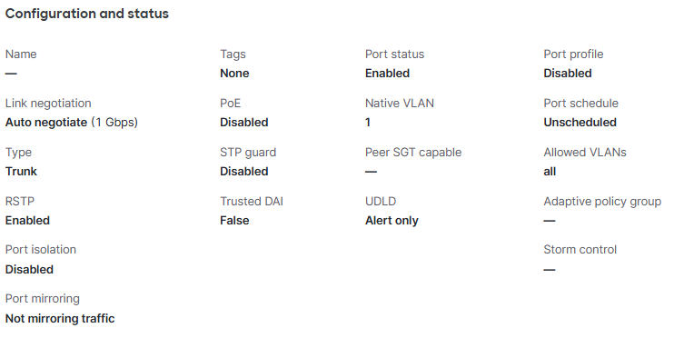

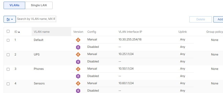

hoping I can get some assistance here and apologies as I know enough to get into trouble but not enough to get all details done. We have an MX105 and setup VLANs on it for some of our devices:

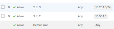

From reading here and elsewhere, I was understanding that if we set the VLANs in the MX, traffic between separate VLANs can take place. I added the appropriate outbound Layer 3 rules in the fireall to allow traffic between VLAN 2 and VLAN 3:
Screenshot 2025-10-13 122346.pngbut I am not able to get one to ping from VLAN 3 to VLAN 2.

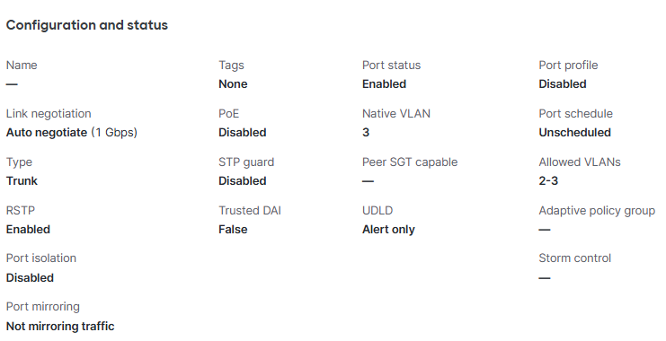

At the switch, I edited the ports for the appropriate VLAN identification:
Do I need to add VLAN interfaces in each switch? Do I need to add routes? Any assistance would be greately appreciated. Thanks in advance!

RWelch
Curious if the port configuration you show is for a TRUNK (switch to switch) port or is this for an end device (access port)?
FSaucedo
Port is for an end device. Does this need to be switched to Access?
RWelch
Yes.

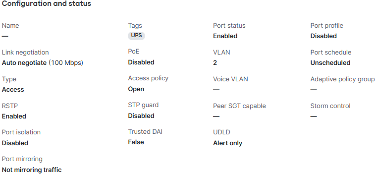

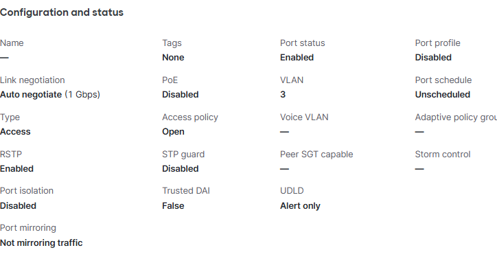

FSaucedo
I changed the switch ports of two devices to Access and specified the VLAN ID's accordingly :
for VLAN2for VLAN2for VLAN3for VLAN3but I am still unable to ping from one to the other. Am i missing something else?

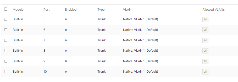

RWelch
The images you show above are for a MS switch and you alluded to having a MX105.
What are the port settings between the MX105 and switch (uplink to the MX)?
FSaucedo
We are using only port 5 in the MX. Here are the current port configurations Uplink port in switchUplink port in switchPorts in MXPorts in MX
RWelch
Pings between VLANs should work.
I just went back and looked at the FW rules and noticed there is missing /24 on the FW entry #9 (the 3 to 2 rule).
And technically since this is InterVLAN routing you don't have to add ALLOW because the default automatically allows VLAN traffic (unless specified otherwise as deny).
FSaucedo
typing too fast obviously....
Unfortunately, even after fixing the typo in the firewall rule, I am still unable to ping the device.
