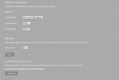

Hi guys,
  I was checking my Wan connectivity on my Z1 and I also noted the Lan4 port setup :
z1_lan4
Not sure how does it behaves, but it's something we've being ask a lot!
