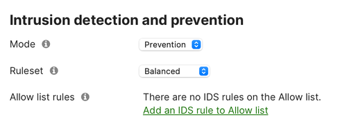

Does anything show up if you try to Add an IDS rule to Allow list?
Security & SD-WAN > Configure > Threat Protection under Intrusion detection and prevention?
Rob2041
Nothing is in that dropdown, however we do have it in detection mode right now.
I wrote bypass rules based on IP addresses, but have not tested these out yet with prevention on. but was hoping to find out what rule is actually causing this issue, or if its the inspection itself.
