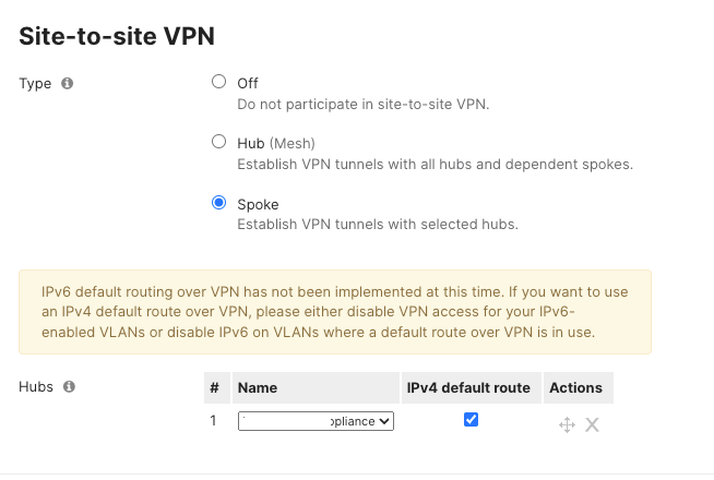

I have a hub and spoke set up with one hub and one spoke. I thought I had set everything up so that all traffic would egress WAN1 (unless failover) of the hub. However, when I look at the event logs for the spoke location I can still see a lot of entries of content filter blocking.
The SD-Wan is set up in a single LAN hub-and-spoke configuration; load balancing is disabled; Active-active autoVPN is disabled; and there are no Local Internet breakout rules defined.
Am I mis-reading things? Does the fact that there are entries in the event log for that location not necessarily mean there is traffic exiting to the internet from that location and it is just blocking there instead of at the hub? I did set up content filtering on the spoke device just in case traffic got out that way, but I expected that the actual filtering would all take place on the hub where the actual traffic was hitting the internet.
As a test I added a domain to the whitelist on the hub that someone at the spoke needed to access and after a few minutes, they still could not reach the site and I could see the entries of the blocking in the event log in their location so I think that proves that they are indeed able to get to the internet directly and it's not just pre-filtering on their device and still exiting the hub.
Have I missed some config somewhere that would force all of the SD-Wan spoke/branch traffic to exit through the hub?
