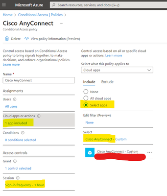

So we have set up AnyConnect to authenticate via SAML with Azure AD for client VPN authentication. We asked the Meraki support to turn off the force authentication option because it makes the users have to type in their full email address and password every time they connect to VPN. However with that turned off, many users are never prompted for their username, password or MFA if they are signed into Office 365 on their computers. What we would like is for the users to not be prompted for their username or password, but still get prompted for their MFA each time they connect. Is this behavior possible to enable either from the Meraki side or from the Azure AD side?

Having said that - you can create a condition access policy and specify a session limit.  Alas in Azure the minimum session limit is 1 hour, but this would at least meant AnyConnect sessions more than 1 hour apart would always require a full authentication again.
