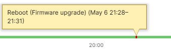

There is some difference yes. It notes  Upgrades and Reboots (when initiated from the dashboard). I don't believe it distinguishes between power outages and other lack of connectivity situations. I've looked at a couple of clients who I know had power outages and they just say no connectivity.
Typically it does indicate the reason, unlike you, I have already noticed that when there is an unexpected reboot it is indicated, just as when you do a firmware upgrade it is indicated that the reboot occurred due to the update.

Those are some example for status. I have seen "Planned reboot" also if it was initiated from the dashboard.
