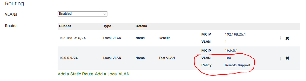

I created a LAB to test the scenario.
The topology is ISP->MX64->Unmanaged Switch->POE Injector->MR18
On MX64 - Created a VLAN 100
Applied a Group Policy on VLAN 100
On MR - Created a SSID in Bridge Mode Tagging VLAN 100
Network-wide->Clients Displays my laptop in VLAN 100 but policy as "Normal"
IP Address is from the desired VLAN 100.
Test I
Modified the Group Policy on MX.
Added the Rule Deny "Social Web and Photo sharing"
Result Access to Facebook is Blocked
Test II
Modified the Group Policy.
Removed the Rule Deny "Social Web and Photo sharing"
Result Access to Facebook is Allowed
So the end result is In my LAB environment the Group Policy on VLAN Works.
Regards
Ajit

If you configure a group policy at the VLAN level, this won't be reflected on a per-client basis. The policy assigned directly to the client will override any policies assigned at the VLAN level. Does the group policy assigned to the VLAN still not work even if the client device has a "normal" policy?

Re: Group policy not working
Hi,
I need to rectify my answer. @AdamB is correct.
Network-wide->client will the display the policy as "Normal". (However I believe even if we apply a Group Policy manually that will overridden by VLAN based Group Policy)
Test I
Test II
Regards
Ajit
ajitsnw@gmail.com
https://www.linkedin.com/in/ajitkumarverma/
