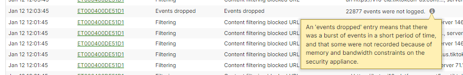

Edit:  I also seem to be getting this error every 2 minutes on the MX250Screenshot 2024-01-12 120441.png

I wanted to give an update on this.  Support couldn't isolate the issue because it was user wide and random so packet captures were near impossible.  Turns out that putting on any Content Filtering with Category Blocking is causing all websites to time out or fail to load.  I removed all Content and Threat categories from the list and suddenly zero sites have an issue.  The minute I add anything back to either of those lists it bogs down and nothing will load without timing out.
