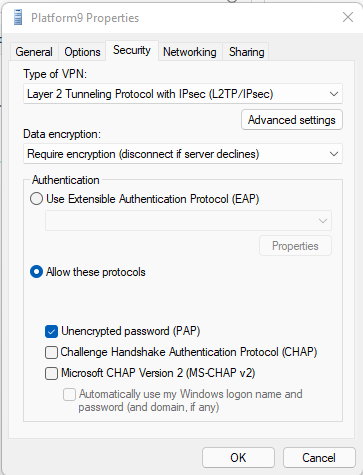

After updating to Windows 11 Pro, I was receiving this error when trying to connect to my VPN: "the connection was terminated by the remote computer before it could be completed".
In reviewing the Event Viewer logs, I saw the following error: CoId={47DD9B6D-A8EC-0007-5147-DE47ECA8D701}: The user SYSTEM dialed a connection named VPN which has failed. The error code returned on failure is 628.
After an hour of troubleshooting (re: googling), I came across this page which worked for me and resolved the issue: https://documentation.meraki.com/MX/Client_VPN/Client_VPN_OS_Configuration#Windows_10.
Evidently, the upgrade fiddled with my VPN > Properties > Security settings. I had to enable "Require encryption (disconnect if server declines)", and then select "Allow these protocols" > Unencrypted Password (PAP).
After this change, I was able to successfully connect to my VPN.
Note: Your mileage may vary depending on OS version, VPN requirements, and other unseen factors which may come into play.
btw... selecting all the protocols, or any other protocols than PAP, failed to allow me to login...
My company has disallowed those protocols specifically.
