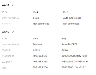

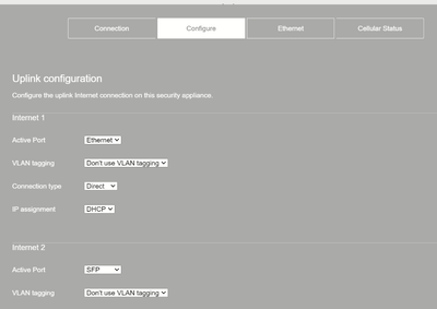

I am trying to setup an MX unit.  Here is the way i have it setup
Internet 1 is set to SFP.  Connection Type is direct and no VLAN tagging.  it's set to static IP address that has the Ip address, netmask, gateway that was given to me by the ISP.  DNS is set to google
Internet 2 is a regular consumer line connection that is set to Ethernet, No VLAN and DHCP.
The internet 2 connection works.  The first one does not.  I have been reading but i don't see where i did anything wrong?  Any help would be appreciated.

I have been in touch with ATT.  This is what they gave me.  Super frustrating as this just drags on.
Chrismt2
Hello,
Make sure that the static configuration on WAN 1 is exactly what the ISP gave. If the configuration is not applying then the MX might be having issues reaching the gateway of the ISP. If you are still having issues I recommend opening a case with Meraki support.

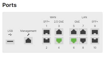

Is your SFP in physical WAN port 1 (top) or 2 (bottom)? And was it inserted on boot?

it looks like this Ryan.
DGrom
Well thats not right.  it was port 2 and 4
Brash
Take a look at the link Ryan posted - in particular the truth tables.
For many MX's, when Port 2 (SFP) is enabled, Port 4 (RJ45) will be disabled.
Try using SFP Port 1 instead.
Keep in mind that after moving the SFP to port 1, you will need to reboot as SFP detection occurs on bootup

And that logic all changes in 18.2 with backup WAN (3rd WAN) in which SFP 1, 2, and copper port 4 are the active ports.
But that aside the MX75-105 use paired WAN interfaces in which if a SFP is detected on boot it will become the active port and its paired copper WAN (if it exists - MX85-105) be be disabled (SFP 1 & copper 3 = pair 1, SFP 2 & copper 4 = pair 2).

I read that and I think i understand now better.  Here is a question, does it matter which active internet is labeled here?  For example  Can internet one be ethernet or does it have to be SFP?
Thanks,
Dan
cmr
Either can be either, but for internet 1 to be SFP then port 1 needs to be used and port 3 needs to have no cable in it.
Brash
You can use either port 1 or 2 for the SFP, but it will impact which port the RJ-45 cable goes.
Using Port 1 for SFP means that you cannot use port 3 for your RJ-45 connection (you'll need to use port 4)
Using Port 2 for SFP means that you cannot use port 4 for your RJ-45 connection (you'll need to use port 3)
