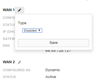

Only thing I know is to go to appliance status - Uplink and set wan2 to "disable". But to be honest, I didn´t do that so far and and it still looks exactly the same.
Is it really disabled?

So got a answer from the Support team:
Support:
From Dashboard you will only be allowed to disable one WAN uplink at the time. If you disable WAN2 you will not have the option to disable WAN1 as well but if WAN 2 is enabled you will have the option to disable WAN1. If you disable WAN2 in Dashboard and disconnect the WAN1 cable from your MX you will that the device will completely lose Dashboard connectivity because the WAN 2 is disabled. The ready status displayed in Dashboard for a disabled interface means that in case you decide to re-enable it the connection will be functional.
Me:
So it really is disabled, BUT its not shown as disbabed like other ethernetports, which are disabled and shown grey?
Support:
Yes, that is correct. The WAN ports are just showing "Configured as: Disabled"

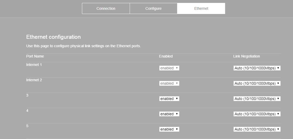

I can use the LAN IP from my computer, but I can´t set it to disable...
Within the "configure" tab I can only do Uplink settings, not disableing, too.

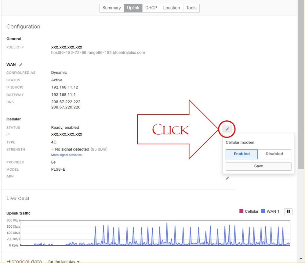

On the Z3C, I can explicitly disable the LTE modem.
Robin St.Clair | Principal, Caithness Analytics | @uberseehandel

I checked, it happens immediately on the Z3C. If Meraki have got it right with one machine . . . .

The picture you posted is of the Ethernet tab. It should be under the configure tab. Were you prompted for local login (usually serial number)
kYutobi
Usually local status page does it like @SoCalRacer mentioned.
