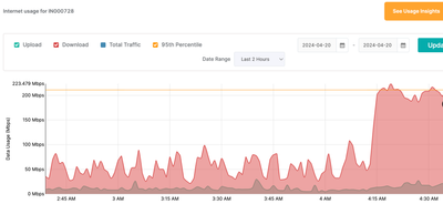

For the last few weeks our office has been experiencing occasional internet slowdowns throughout the day. Usually once or twice during the day and will last about 15 to 30 minutes. Each time we see that the network usage spikes really high causing the entire network to slowdown or not load anything (wired and wireless). I wanted to see if anyone had some advice on where I should start my troubleshooting. Are there any logs available to find out what devices may have caused this?
I figured Global bandwidth limits would help, but it didn't. (20mbps with speedburst enabled)

Utilization graph from our ISP.

Does the issue correlate with any update cycles for devices? Eg. Windows or office laptops. You could take some captures on the MX WAN port and see if there is a large amount of traffic coming from a single device or going out to a single IP address

I agree with @Ryan_Miles. There is a clear spike in traffic but does that spike correlate with the time of slowdown? The graph shows 4am. Are there server backups happening or software downloads scheduled to happen at this time of slowdown? You can use the network-wide>clients page to track down any abnormally high usage users as well. Plugging directly into ISP with a laptop and running a speed test and then plugging into MX running a speed test could be helpful as well. Theres likely to be a drop in those speed tests going from the MX but can help isolate to whether the issue is on ISP side or your side. Preferably use iperf to speed test but a browser based one can give you good baselines as well.

My go-to method is to take a packet capture (say 5 minutes in your case), and then run it up in WireShark.  Use some of the IO tables to see what the biggest sends/receivers are and what protocols are being used.

Does the graph correlate to workers starting their shift? Have you looked in your dashboard so see if any one device is using large amounts of bandwidth during this time. I would setup a daily summary report for that Meraki network and see who your top devices are and if they are sending a lot more traffic than everyone else.
