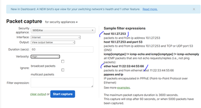

Try to perform a packet capture using the client's IP or MAC as the source.

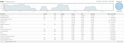

Assuming you have an MX, if you go into the client and click "Show Details" under the pie chart - what does it show them accessing?
Vipul
Looks like plain old Windows file sharing.  Or are you talking about Internet traffic as opposed to internal traffic?
Vipul
That is our on-premises file server, and the user is connected to the same network. But different VLAN.
Brash
From the above output, the clear majority of network traffic from that client is SMB file sharing.
If that's an unexpected usage amount, you'll have to get a clearer idea of what they're pulling down from the file server and why.
To prevent it, you could look at applying group policies and setting bandwidth limits via a traffic shaping policy.
