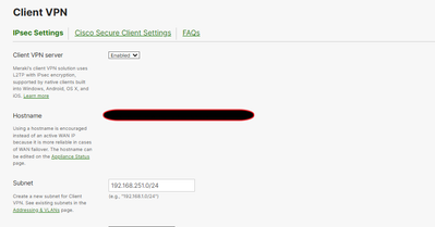

Hello,
Client connects to spoke via Client VPN but cannot reach hub servers (192.168.98.0/24). Route to hub network doesn't appear in client's routing table.
Issue:
  • Hub has servers on 192.168.58.0/24
  • Users connect via Client VPN to center on  spoke
  • Cannot reach hub servers - no route appears in client routing table
Question:Should the spoke MX automatically advertise hub networks (learned via AutoVPN) to Client VPN users?
Is this a missing configuration or an unsupported scenario?
Or is it necessary to set up the Client VPN on the hub if the customer wants users to connect from another spoke device for security or any other reason?

Have you enabled Client VPN &/or AnyConnect subnets on the Site to Site VPN page?
athan1234
A model citizen

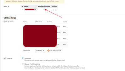

In the spoke's Security & SD-WAN > Configure > Site-to-Site VPN under "Local networks", I see:
  • Client VPN: Enabled, 192.168.251.0/24
Should I add the hub network as an additional entry?
  • Name: Hub Servers
  • VPN mode: Enabled
  •  there is not opcion to add a Subnet: 192.168.98.0/24
Will this tell the spoke to advertise hub networks as accessible to Client VPN users through AutoVPN?

One more thing — is it possible, in the spoke, to check the IPv4 default route to reach the hub?
Try adding the route manually on your Windows computer.
https://documentation.meraki.com/MX/Client_VPN/Configuring_Split_Tunnel_Client_VPN
athan1234
A model citizen
Okay, it's an option, but then each user will have to add the route to reach the server — it's a mess.
Do you think it will work if I check the default IPv4 address?
When configuring hubs for a spoke, there is an option to select a hub as a Default route. If this option is selected, then that hub will be configured as a default route for the spoke (0.0.0.0/0). Any traffic that is not sent to a configured VPN peer network, a static route or local network will be sent to the default route. This routing will apply to any traffic originating from subnets set to, "In VPN" or that have VPN mode "Enabled."  Subnets that have VPN mode "Disabled" will not adhere to the VPN routing tables. Multiple hubs can be selected as default routes. Hubs marked as default routes take priority in descending order (first priority at the top).
https://documentation.meraki.com/MX/Site-to-site_VPN/Site-to-Site_VPN_Settings
