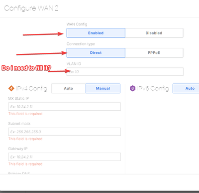

What best practices should I follow to configure the Secondary Uplink as a spare? (in case the primary goes down, I want the secondary to failover)

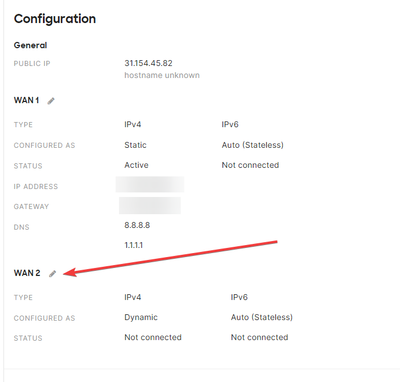

Is it ok to change or edit  the IP address of the secondary uplink via the Dashboard? or should I do it only via the local status page?
According to Meraki Support:chrome_Q1LFbDS8B6.png
"Note: Modifying the state (enabled/disabled) or addressing method (static/DHCP) of a WAN connection from Dashboard causes both WAN interfaces to reset, which results in a loss of connectivity on both Internet uplinks for up to 2 minutes. Therefore, it is recommended to only make changes during a planned maintenance window so that disruption is minimal."
Thank you!
You can configure on the dashboard or on the local status page.
Just configure WAN 2 that won't cause any outages.
