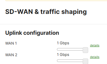

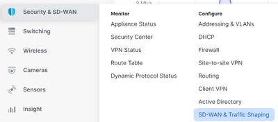

Is SMB bandwidth throttling enabled?  You should be able to check this from PowerShell with:
Get-SmbClientConfiguration | Fl EnableBandwidthThrottling
If it is, you can try turning it off with:
Set-SmbClientConfiguration -EnableBandwidthThrottling 0
Are there any funny speed limits configured here?
If you do a "plain old Internet speed test" at each site, are you seeing the expected Internet throughput?
