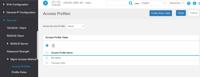

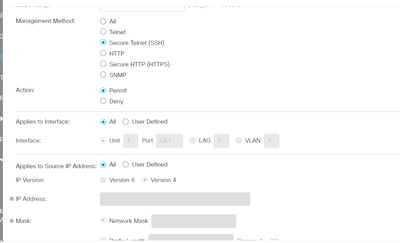

Have tried creating an access profile?
I do not have remote access to the CBS interface, I will check this next week point, thank you very much for the help. I will keep you informed
