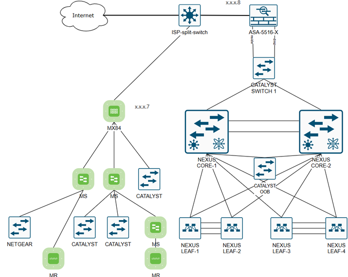

Hello, Team,
I hope you are all doing well.
I've been working on migration from ASA 5516-X to MX84 for quite some time now but being pulled into other projects in the meantime.
I've successfully managed to lose remote SSH access to the Core and Catalyst switches on the fence of the ASA while trying to migrate the STP from RSTP to MST.
What are the first steps to process with this migration?
Do I plug the inside and dmz ports from the CATALYST SWITCH-1 into the MX free ports and replicate the configuration as per the ASA?
I've seen in some of the other posts that any non-meraki switch must be in MST. As you can see the topology is a mixed bag of vendors, thankfully mostly 99% Cisco!
How would I make sure the migration is successful and that I use a Meraki MX instead of the ASA?
I am currently running native vlan 13 on the Meraki side of the fence, whereas on the ASA part the native vlan is 1000. Will I have to change this and how to make sure I don't lose access to the NEXUS Cores and leafs? Make the change and each individual box?
Please feel free to criticise the network topology design and suggest to me best practices methods.
I am looking forward to hearing from you.

nikolaycholakov
Ideally, I want it to be directly connected to the MX84.
or even bypass the CATALYST-SWITCH-01 too:
Which will be the better option?
How would I achieve the desired outcome? What issues will I come across? How to prevent them?
Mloraditch
My main comment would be, why are you replacing a 5516 with an MX84? Both devices are announced EOL in 2026 and the 5516 provides more throughput and features. I can certainly see if your setup is simple enough migrating from ASA to MX, but I would want to be implementing a current model so I don't have to change things again in just over a year.
For STP I encourage you to read this article: https://documentation.meraki.com/MS/Port_and_VLAN_Configuration/Configuring_Spanning_Tree_on_Meraki_...
There is example code for IOS interoperability and an overall section on interoperability. I can't speak specifically to an environment such as yours you would have to consult the documentation for each vendor/operating system.
Regarding your comment about the ports connecting the firewalls to the switches, yes the trunking settings will have to match. I don't have a specific recommendation as it's really an either or scenario. One side you will have to change and one side you won't. It doesn't IMO matter which one.
Honestly my biggest recommendation is perhaps work with your partner or account manager and get some engineering assistance. You have a somewhat complex environment and I'm guessing based on the Nexus switches perhaps some mission critical items. What you want to do is definitely doable but may require more detail to properly plan than we can realistically provide here.

It will certainly be simpler, I would just verify your throughput needs won't be hampered. The MX84 will cap out around 320 mbps if security features are enabled and 500mbps total. The 5516 can handle up to 1.8Gbps total and 450ish if security features are enabled.

Is there any reason you can't do a "big bang" cut over and just move everything at once?
Don't forget to change the Nexus switches to using MST as well.
You have two connections between your ASA and Catalyst-1, inside and dmz.  If these ports are "switchports" on Catalyst-1 (as opposed to L3 ports), you'll need to convert these to a single trunked connection before migrating them across to the MX, otherwise spanning tree will shut one of the ports down.

I highly appreciate your input. This is what I was looking for! I was thinking if I should create a PortChannel with the new ports towards the MX or just use a single link. I will try the single link tomorrow.
Currently, the config of the ports towards the ASA are:
interface GigabitEthernet1/0/4
description #### ASA 5516-X MGMT PORT ####
switchport access vlan 250
switchport mode access
interface GigabitEthernet1/0/1
description #### ASA 5516-X PORT 4 - INSIDE INTERFACE ####
switchport access vlan 1000
interface GigabitEthernet1/0/2
description #### ASA 5516-X PORT 5 - DMZ NETS ####
switchport trunk encapsulation dot1q
switchport trunk allowed vlan 1840-1855
switchport mode trunk
Will the new port towards the MX from the Catalyst look like this to make it work:
interface GigabitEthernet1/0/3
description #### MX84 PORT 8 - DMZ NETS ####
or
switchport trunk allowed vlan all
or
switchport trunk allowed vlan 250, 1000, 1840-1855
MX does not support port-channels.  You can't use them.
