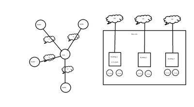

Here is a topology of what we have existing (hub and spoke - left) and the new site (right).
All existing sites use AutoVPN to connect back to our central hub for DC connectivity. I still need this for the new site too so I would typically use AutoVPN to connect the back to the central hub. But how would I then get the CCTV cameras across the 3 new buildings to communicate with the NVR in building 1 and still be able to connect them all back central for DC server connectivity?

I don't understand, if you have 3 MXs (one for each building) why wouldn't the cameras be able to communicate with the NVR in building 1? What is the CCTV system you have? Does it require layer 2 adjacency between the cameras and the NVR?
Meraki Autovpn supports spoke to spoke communication, which should address your concern (unless I'm not understanding what you are asking 🙂 ).
Thanks!

I think what you are suggesting is sending all traffic from building 2 (for eg.) back local to central hub and then back out the other spoke in building 1.
We need local communication in case of ISP issues and local recording functionality.
Each site will require its own unique subnet range.  You'll enable AutoVPN on the MXs to network all the sites together.
