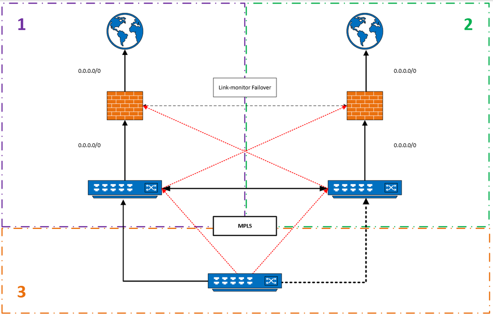

We have been asked to determine which devices we should now select to replace the Core switches. I will give you an overview so you can better understand our needs.
We have 3 sites very close to each other, within a 10 miles radius.
Site 1 - in purple
This is the primary site; it’s where we have the largest number of users.
It is connected to Sites 2 and 3 via MPLS (10GB fibres)
Has a dedicated Internet link for outbound traffic.
Site 2 - in green
This is the secondary site.
It is connected to Site 1 via MPLS. (10GB Fibres)
Connects to site 3 via Site 1. (10GB Fibre)
Site 3 - in orange
Small tertiary site.
Piggybacks of Site 1 via MPLS, for both LAN and Internet Access. (10GB Fibre)
Has a fibre connected to both sites 1 and 2, but it is a cold failover that requires on-site intervention. In case of manual failover, will piggyback of Site 2 instead.
Core to Access switches uplink
This will most likely be a mixture of new 10GB fibres and old copper cables. In some cases, we won’t be able to replace the existing RJ cables. They are feeding small switches with OT devices, that do not require a lot of bandwidth to work. (mostly on site 3, it's a very old building with very thick walls).
I believe that we could go ahead with fibre core switches and use the odd copper transceiver if needed, instead of a switch with both interfaces.
Firewalls and Internet connectivity
The firewalls are configured with link-monitoring static routes, which will allow each firewall to re-route the internet traffic to the other site in case it goes down. However, this is only good from this point forward. If the connection between the core and the firewall goes down, with the current config, it is not rerouted automatically – A static route needs to be configured.
Things we are looking to resolve with the new setup – dotted in red:
1 – Automatic Failover connectivity from Site 3 to sites 1 and 2. This is pretty much our warehouse so there is no need for high performance, as long as it is reliable and stable.
2 – Define necessary routing, between sites 1 and 2, to detect when the link between the core and local firewall is down, changing the default route to the other location.
Other than static, the existing firewalls support OSPF, BGP or RIP. The switches would need to be at least compatible and capable of doing some routing both between them, and with the firewalls.
The existing routing is pretty much all static so whatever we decide to do will be done from scratch.
One last thing to have in consideration: Compatibility of Meraki SFPs with other vendors – Fortinet, Dell, Cisco Catalyst. Anything I should be aware of?
They have not considered the change from the current MPLS setup to SD-WAN. I don’t know if putting in MX devices is a requirement for this to work. Ideally, from a budget perspective, they would prefer not having the MXs.
Again, I am new to Meraki, so I was wondering what the best practice would be, as well some additional configuration that currently does not exist, to achieve our goal.
I would be very grateful for all the help you can provide.
Thanks,
Mike

You have only given an overview of your network, ideally you would gather all the requirements for your network and then contact your Meraki/Cisco sales consultant to support you in defining what is best for you.
Mloraditch
The two things you are looking to resolve are not exactly the easiest to do in a Meraki environment. The level of routing you need to make this work automatically is not available in Meraki right now.
If your team has a desire to move to a fully Meraki setup, this is where I'd consider switching your MPLS circuits to DIA and putting in MXs at each site.
Regarding your comment about SFPs, there are generally not issues with Meraki SFPs interfacing with other vendors SFPs in their gear.
I did notice you mentioned MS120 switch models. These are end of sale next month and end of support announced for 2030. I would be looking at MS130s or MS150s for your access layer and perhaps 9300s for your core.
Overall, I strongly recommend working with your Cisco account rep and partner to get into detail with your requirements and make sure you can get the solution you need.

Hi Mike,
The best advice I can give you is determine which Meraki reseller you will be working with and then ask for Free Trial equipment from them. Also get the name of your Cisco sales rep and tell them that you would like support from the Free Trials Adoption Team. What this team does is walk customers through the setup/implementation of their equipment so that you have a successful transition.
Best of luck.
Kathleen

Thanks everyone for taking the time reading this post.
I will certainly follow up with our Cisco/Meraki rep and ask for some guidance. Before doing so, I wanted to explore our options and be prepared for that chat.
@Mloraditch  Regarding the SFPs, I did find and issue with Meraki SFPs and Dell devices. While operationally it works - link is established, traffic goes through, no errors clocking up - I am unable to see any light levels or other information concerning the physical layer on the Dell switch. It is simply up and running. Not a blocker but can make life difficult if troubleshooting is ever needed on that specific link.
We will need to keep the MPLS links as we have on-prem DC in 2 of the sites and they need to communicate/replicate large amount of data. I don't think they will approve the MX setup with DIA mainly due to budget limitations, but worth asking.

Hi Mike,
I wanted to address your SFP issue. SFPs are incredibly proprietary and so you will need to use one brand for the Meraki side and one brand for the Dell side. It is very possible that there is a Finnesar (just throwing out the first name that comes to the top of my head, this is not an endorsement) that will work in both models but you will need to do some google searching to find a compatible model for both brands.
I hope this helps.
Kathleen
MisterMike
Thanks Kathleen, I will have a look at Finnesar. Right now it is working fine but it is something i would like to revisit and not leave it to chance.
Thanks,
Mike
