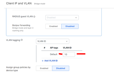

I assume the DHCP mode on the SSID is set to bridge.
In that case, you have to configure the VLAN Tag in the SSID for the VLAN you want.

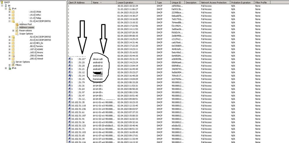

yes, I looked at them and tried, but there is a situation like this.
Users connecting to the access point receive ip from the block they should not receive.
because the access point mngmt blocks 51 , 52 , 53.
Other ip fields are ap s on sws they are correct.

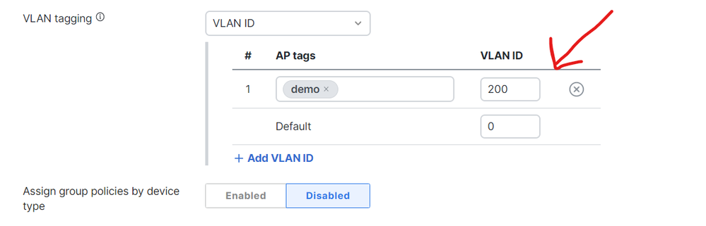

Is it my mistake here? I say add vlan and add the vlan I want to migrate. Do I just say default vlan and enter vlan number?
Do your APs also have that tag "demo"?
Ryan / Meraki Solutions Engineer
No instead of connecting to the system I asked if there was a mistake we made on my own demo.
Yes, change it to just have VLAN 200 in the default line. No need for that "demo" line.
