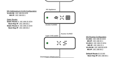

Basically, you need to create a default route in MS pointing to MX as the next hop and routes in MX to the subnets you created in MS pointing to MS IP as the next hop.

Your route on the MX is wrong.
Take a look at this example:
Just to be clear, the way it's configured in MX you're causing route asymmetry every time packets are forwarded.
What you need to do is create a summary route or specific routes for each subnet.
